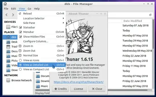

Thunar --- View Settings
The image shows the View dropdown with the various options. The Show Hidden Files and View as Detailed List settings behave as expected.
The changes should be reflected in ~/.config/xfce4/xfconf/xfce-perchannel-xml/thunar.xml.
Here are the contents of thunar.xml with the Show Hidden Files and View as Detailed List settings active:

Of note are the values of property name="last-show-hidden" and property name="last-view".
Could it be, though I can't say why, that your ~/.config/xfce4/xfconf/xfce-perchannel-xml/thunar.xml is damaged or that it doesn't have the appropriate permissions or that Thunar cannot, for whatever reason, write changes to this file?
