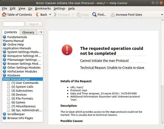

  • UNIX manual pages - renders with error:
    The requested operation could not be completed
    Cannot Initiate the man Protocol
    Technical Reason: Unable to Create io-slave
    man protocol error in khelpcenter

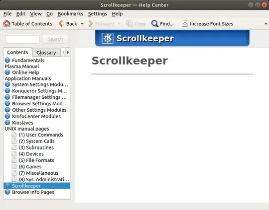

  • Scrollkeeper - shows empty page:
    scrollkeeper empty page in khelpcenter

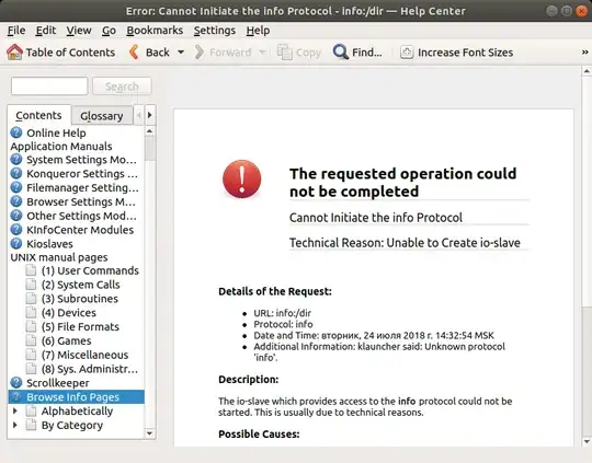

  • Browse Info Pages - renders with error:
    Cannot Initiate the info Protocol
    info page error in khelpcenter

Problems with info: and man: links are gone after installation of these packages (idea from this answer):
sudo apt-get install kinit kio kio-extras kded5

KHelpCenter internally use ScrollKeeper's component scrollkeeper-get-content-list (located in rarian-compat package), so we need to install it:
sudo apt-get install rarian-compat
To add content to Scrollkeeper category we need to install some application which has documentation in /usr/share/omf:
 sudo apt-get install synaptic diffuse
But its installation does not help. ScrollKeeper category contains very small amount of objects, their pages fail to render.
