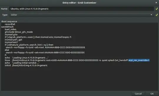

If you want you can use the tool grub-customizer by adding the text highlighted in blue:
GRUB editor screen - text added to line beginning linux
Restart your computer - very important!!

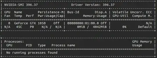

Now you can use all the memory in your NVIDIA GPU. You can verify that by calling the command `nvidia-smi:
nvidia-smi output
