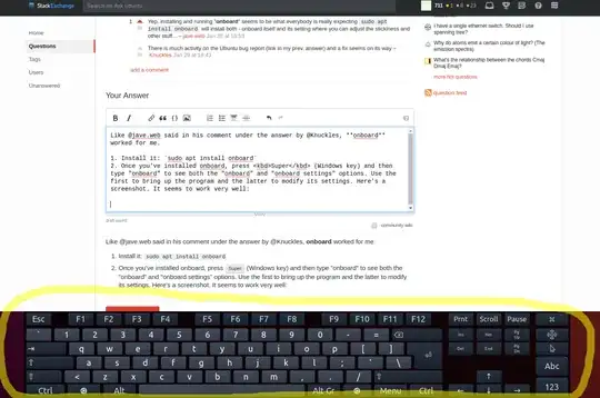

  3. Here's a screenshot. It seems to work ok:
Also note the little icon in the top right of the screen you get to it now too:
