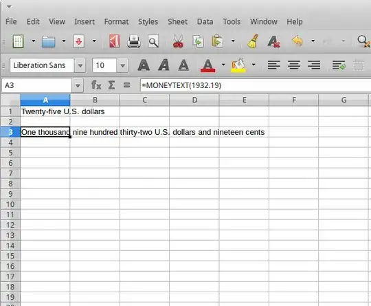

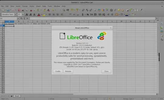

This works with LibreCalc 6.0.3.2 in 18.04 LTS and I have tested it with 6.0.5.2 in 16.04 LTS.
Download the Extension from https://extensions.libreoffice.org/extensions/numbertext-1
Then go to Tools --> Extension Manager in LibreOffice Calc
Click Add, then choose your downloaded file.
If the extension does not work, check if the package libreoffice-script-provider-python is installed and install it if it is missing.
If you want the text to lower case it would just need to be done like so:
=LOWER(MONEYTEXT(1932.19))
And for upper case it would be relatively the same:
=UPPER(MONEYTEXT(1932.19))
Hope this helps!
