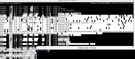

I have similar problem except my problem is not able to return any Chinese character in next column >.
The first thing I do is run watch -n 3 -d 'ps auxww|tac' to compare what's the difference between the output when success(first column) and failure(next column) occur.
I quickly noticed that /usr/lib/ibus/ibus-engine-libpinyin --ibus still running on success but disappear on failure.
That means /usr/lib/ibus/ibus-engine-libpinyin --ibus process crash when select character in next column.
Since the previous process is gone, while Super+Space to toggle new libpinyin process, select the first column, then run ps auxww in another terminal to know the latest pid is 6798, run sudo strace -ff -vvv -p 6798 -s 1000000 to understand the process:
