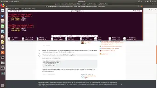

Screenshot of my attempt to edit the "gtk-widgets.css" file
Upon attempting to save the changes I made to the widths of the scroll bars, the error message appeared:
Error writing gtk-widgets.css: Permission denied"
(I attempted the solution posted @16:14 on 19 January by Carlos Alberto Martinez Gadea).
