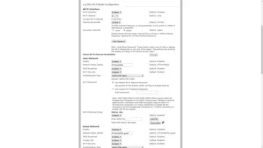

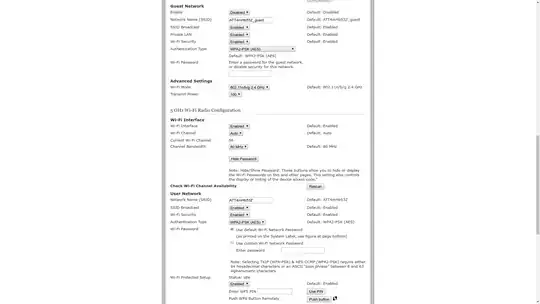

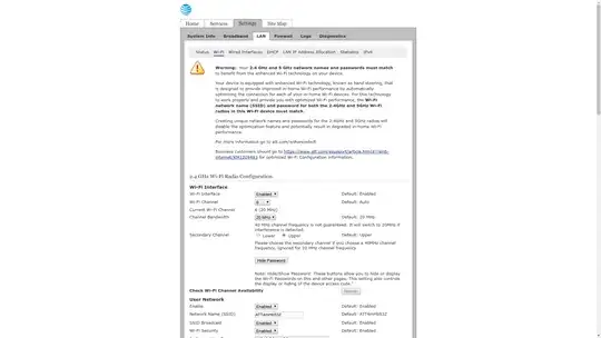

Screenshot 1
Screenshot 2
Screenshot 3

Did you select channel 1 intentionally, not realizing that it is the most congested channel in your area? Or, more likely, is your router set to auto-select the channel. This interesting post shows why auto-select is a very bad idea: https://superuser.com/questions/1311149/why-do-wifi-routers-do-such-a-bad-job-of-channel-selection
Please set your router to a fixed channel, ideally channel 6, and tell us if the connectivity is improved.
EDIT: Check all of the settings in the router. WPA2-AES is preferred; not any WPA and WPA2 mixed mode and certainly not TKIP. Second, if your router is capable of N speeds, you may have better connectivity with a channel width of 20 MHz in the 2.4 GHz band instead of automatic 20/40 MHz, although it is likely to affect N speeds. Also, be certain the router is not set to use N speeds only; auto B, G and N is preferred. After making these changes, reboot the router.
