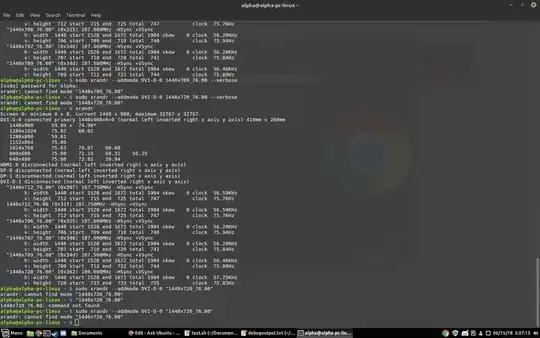

How to set a custom resolution? I followed the instructions here, but xrandr cannot find the mode when I try to add it (I am using 1440x709 to test)
(for reference i am on a GTX 1050 Ti with NVIDIA driver 390.67)
Updated screenshot from terminal:
Image]
K7AAY
  • 17,705
  1. Only lower resolutions are allowed.
  2. I needed sudo for newmode and addmode.
  3. I edit the mode line, e. g. 1400x700_60.00 to 1400x700.
  4. I wrote a sh script to set Resolution on each reboot.
Check with xrandr without Extension if addmode was successful.
