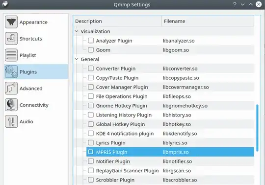

Qmmp has the mpris plugin, but it is disabled by default and needs to be enabled under Settings-Plugins-General section:
