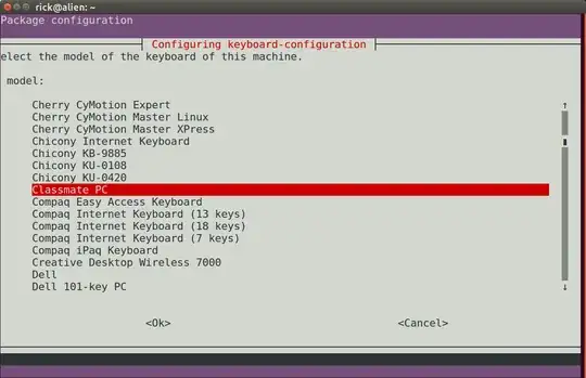

According to this Lenovo webpage which sounds like your problem you can use:
sudo dpkg-reconfigure keyboard-configuration
Then scroll down to classmate PC and select it:
classmate PC keyboard
Hope this helps.
