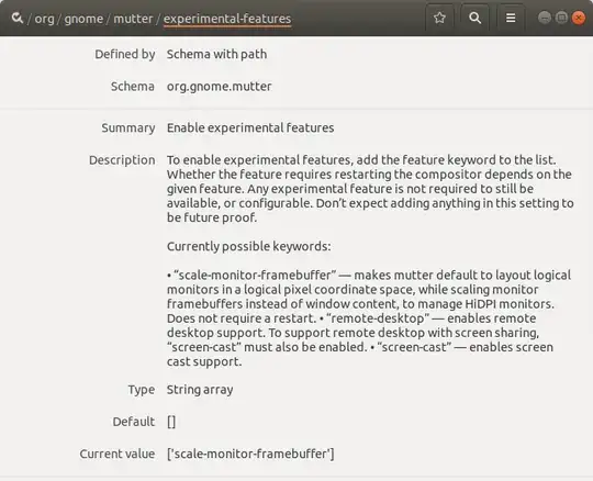

Enable fractional scaling experimental-feature:
gsettings set org.gnome.mutter experimental-features "['scale-monitor-framebuffer']"
Then open Settings -> Devices -> Displays
fractional scaling experimental-feature in dconf Editor

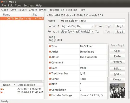

For example kid3 application without forcing scaling factor:
kid3 no scaling

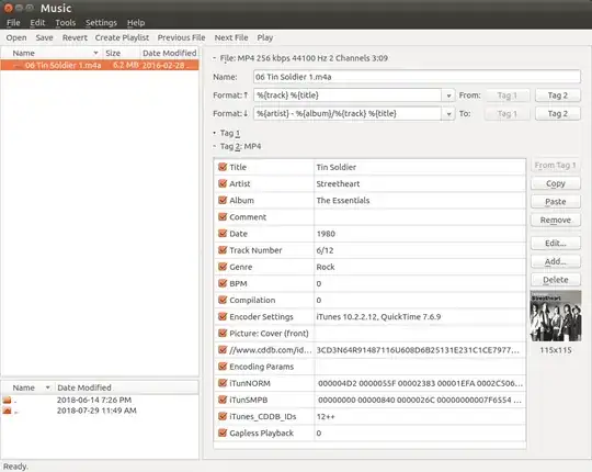

The default scaling is 96 dpi. So we'll override it by using:
xrandr --dpi 144
kid3
And now we see:
kid3 with scaling
