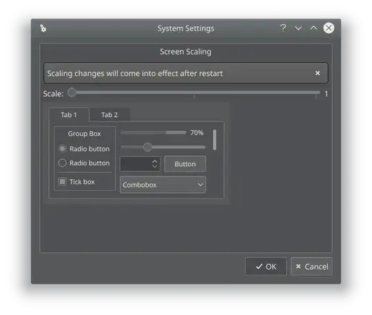

In KDE Plasma (I'm using Kubuntu 18.04):
  1. Settings
  2. Display and Monitor
  3. Displays
  4. Advance Settings
  5. Scale Display
Move the slider to the scaling level you desire, click Apply, then reboot.
