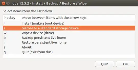

If you want an easy and safe way to restore a USB pendrive to a standard storage device, you can use mkusb.
Find more details at the following links,
mkusb - how to install mkusb from a PPA ... - Ubuntu help link
mkusb/wipe - wipe and restore - Ubuntu help link
Restore to a standard storage device - AskUbuntu link
Installation/FromUSBStick - Postrequisites - restore the USB stick - Ubuntu help link
