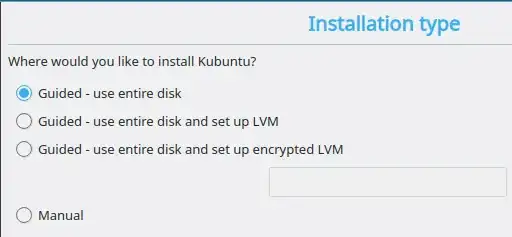

I have a 1000GB hard drive, I just want to install (k)Ubuntu with encryption on the first 100GB of the HD.
however, I only have the option of full disk encryption :
picture why ??
if I choose "custom" or "manual", I can only create partition, but not encrypted...

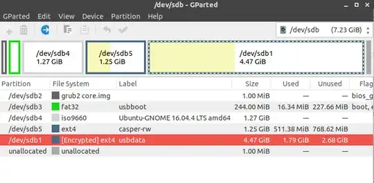

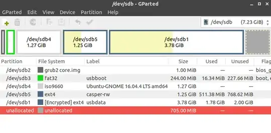

I am not aware of a way to do it during the installation process; but, if you are trying to install Ubuntu 18.04, you can encrypt the entire disk and AFTERWARDS use GParted to resize the encrypted partition to the 100 GB you need.
Bionic Beaver comes with GParted 0.30 which can resize LUKS partitions just fine. Support was added in GParted 0.28
https://news.softpedia.com/news/gparted-0-28-0-adds-partial-read-write-support-for-luks-encrypted-filesystems-512943.shtml
GParted has a very nice GUI to handle partitions, and is included in the live-CD. You can use Disks to check the status of your partition before resizing
  1. LUKS partition unlocked

  1. No key in front of the encrypted partition
No key in front of the Encrypted partition
  1. Encrypted partition resized
