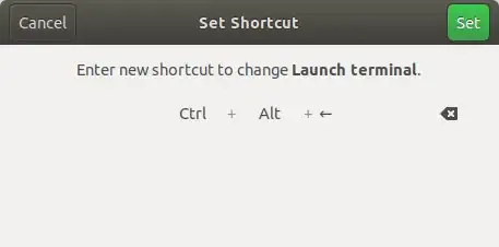

In Ubuntu 18.04 I'm not able to assign Ctrl+Alt+ or Ctrl+Alt+ to anything. To be precise I may bind it to something, but it doesn't work when using the keyboard combination, up/down arrows do however work.
See screenshot here.
The strange thing is that the system detects the keyboard combinations when assigning a key, but not when trying to use them. As a result the keyboard combinations don't work in any other programs either.

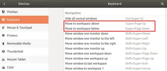

The problem is that the Ubuntu 18.04 Settings GUI doesn't show all the keyboard shortcuts.
  • It doesn't list "Move (Switch) to workspace to the left/right" (even though there is a shortcut assigned).
  • It only shows the first keyboard shortcut if there are multiple shortcuts for a command, like for "Move (Switch) to workspace above/below", which actually has a second keybinding for Ctrl+Alt+up/down.
