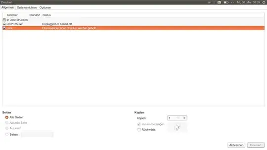

However, in the print dialogue of my documents there is an additional entry. Besides "print to file" and my installed "Epson" there ist an entry which reads: "print - rejecting jobs" If I click on it, it says "getting more information on printer" indefinitely. Also, if I turn off the installed Epson printer the entry disappears and reappears if I turn the Epson printer on again.

Screenshot, the problematic entry is highlighted
