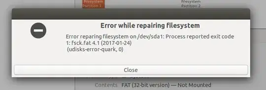

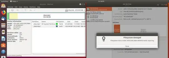

Edit: Images of GNOME Disk check GNOME Disk Check Error when trying to fix Error
