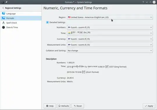

Setting the Time format:
regional settings ... and the Plasma lock screen shows: lock screen with correct time
