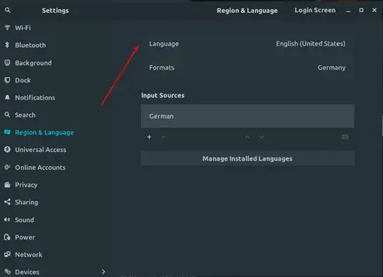

This mostly happens if the language setting on your system got messed up, to fix this simply re-set your language settings (see Screenshot).
After this your terminal should work as expected.
