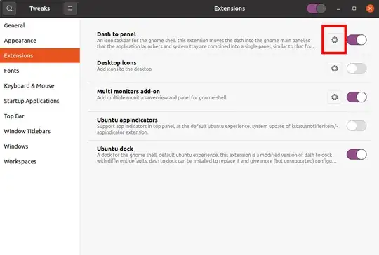

  1. Open Tweaks -> go to Extensions
  2. Enable Dash to panel

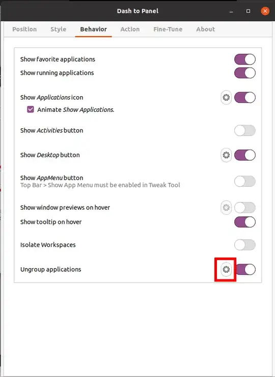

  3. In Dash to panel -> click Settings Icon
  4. In Behavior tab, enable Ungroup applications

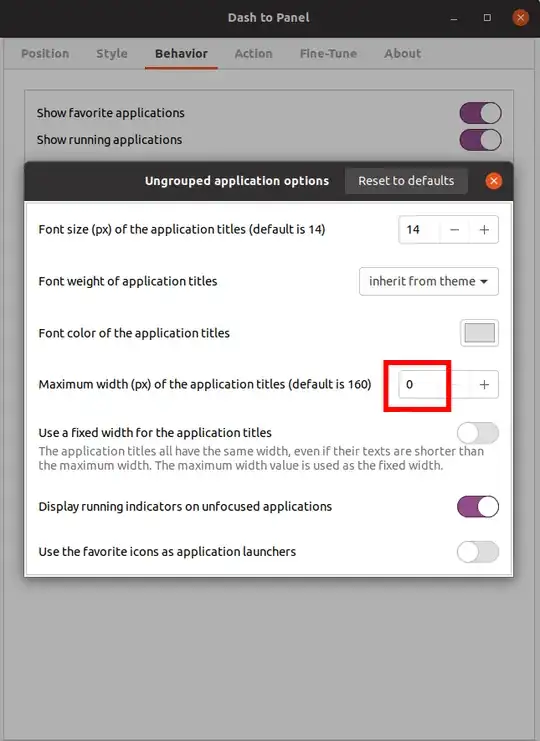

  5. In Ungroup applications -> click Settings Icon
  6. Set Maximum width -> 0 (zero)
