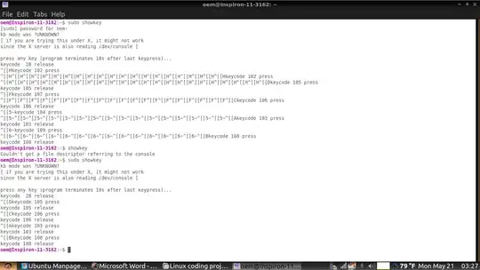

BACKGROUND: This was one of the most helpful articles for me but I don’t know enough to come up with the right code still. BACKGROUND: Since my Linux experience totals all of about 3 weeks after being a Windows slave since DOS-days, I found the following articles that are somewhat specific to the problem helpful. BACKGROUND: I used something called showkey to show key codes that showed the presses without the release:
showkey output: showkey output
You can see how the first press of the key presses but since there is no release event, it goes on, until I hit any other key. The order of the key press attempts is fn+left arrow (home, code 102), fn+right arrow (end, code 107), fn+up arrow (pgup, code 104), and fn+down arrow (pgdn, code 109). The bottom of the page output is for pressing only the arrows to show that they have different codes and that they have release events right after the press event. In the same order above (left, right, up, down), the codes are 105,106,103,108 (which is the same ass what evtest below shows)

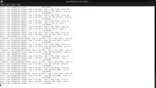

BACKGROUND: I used something called evtest to show key codes and events: The order of the key presses are fn+left arrow (home, code 105), fn+right arrow (end, code 106), fn+up arrow (pgup, code 103), and fn+down arrow (pgdn, code 108),
Evtest output: Evtest output
