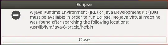

When I execute ~/eclipse/php-oxygen2/eclipse/eclipse for eclipse, it executes successfully. But for the command, ~/eclipse/php-oxygen/eclipse/eclipse, coming from the same package, I get the following error:
I am at a loss to find out how the above value has been set.
Even the following command,
export JAVA_HOME=/opt/jdk-10.0.1/; ~/eclipse/php-oxygen/eclipse/eclipse
produces the same error.
Could somebody please tell me where else can I look to find the source of this spurious value? Eclipse does not have an option in preferences to set JAVA_HOME (internally).
