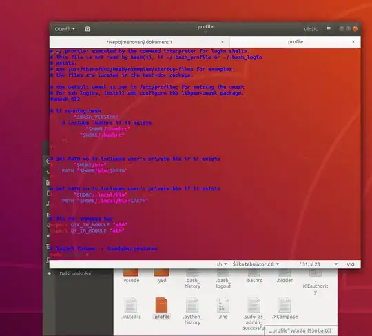

I followed this advice, installed uim and set it as GTK_ and QT_IM_MODULE but every sequence starting with the <minus> <0> line gets ignored. When I tried xim, it did a bit better but it made gedit glitch:
xim glitch
When I tried GTK_IM_MODULE=gtk-im-context-simple, most of the sequences started working, but some of them just don't.
