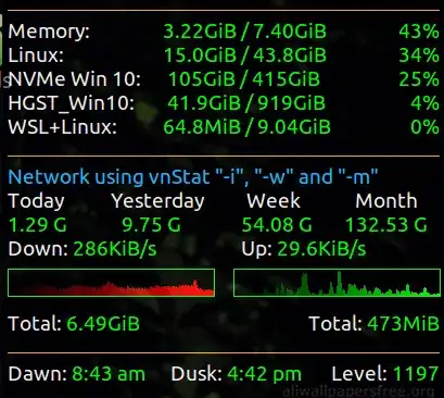

Conky Real Time Display example
Conky is a popular light-weight System Monitor used across many Linux distributions. You can show vnStat bandwidth totals in your conky display like this:
30 second .gif of Conky's relevant section
The Conky code to produce this display is:
${color orange}${voffset 2}${hr 1}
${color}Memory:${goto 148}${color green}$mem / $memmax $alignr${color green}${memperc /}%
${color}Linux:${goto 148}${color green}${fs_used /} / ${fs_size /} $alignr${color green}${fs_used_perc /}%
${color}NVMe Win 10:${goto 148}${if_mounted /mnt/c}${color green} ${fs_used /mnt/c} / ${fs_size /mnt/c} $alignr${color green}${fs_used_perc /mnt/c}%${else}${color yellow}/mnt/c${endif}
${color}${if_mounted /mnt/d}HGST_Win10:${goto 148}${color green} ${fs_used /mnt/d} / ${fs_size /mnt/d} $alignr${color green}${fs_used_perc /mnt/d}%${else}Cache RAM:${goto 148}${color green}${cached} ${color} Buffers: ${color green} ${buffers}${endif}
${color}${if_mounted /mnt/e}WSL+Linux:${goto 148}${color green}${fs_used /mnt/e} / ${fs_size /mnt/e} $alignr${color green}${fs_used_perc /mnt/e}%${else}Swap:${goto 148}${color green}${swap} / ${swapmax} $alignr${color green}${swapperc}%${endif}
${color1}Network using vnStat "-i", "-w" and "-m"
${color}${goto 5}Today ${goto 100}Yesterday ${goto 225}Week ${goto 325}Month ${color green}
${execi 10 vnstat -i enp59s0 | grep "today" | awk '{print $8" "substr ($9, 1, 1)}'} ${goto 110}${execi 10 vnstat -i enp59s0 | grep "yesterday" | awk '{print $8" "substr ($9, 1, 1)}'} ${goto 220}${execi 10 vnstat -i enp59s0 -w | grep "current week" | awk '{print $9" "substr ($10, 1, 1)}'} ${goto 315}${execi 10 vnstat -i enp59s0 -m | grep "`date +"%b '%y"`" | awk '{print $9" "substr ($10, 1, 1)}'}
${color}Down: ${color green}${downspeed enp59s0}/s ${color}${goto 220}Up: ${color green}${upspeed enp59s0}/s
${downspeedgraph enp59s0 25,190 000000 ff0000} ${alignr}${upspeedgraph enp59s0 25,190 000000 00ff00}$color
Total: ${color green}${totaldown enp59s0} $color${alignr}Total: ${color green}${totalup enp59s0}
${color}${goto 5}Dawn: ${color green}${execpi 300 cat /usr/local/bin/sunrise} ${goto 155}${color}Dusk: ${color green}${execpi 300 cat /usr/local/bin/sunset} ${alignr}${color}Level: ${color green}${execpi 10 cat /sys/class/backlight/intel_backlight/brightness}
To save desktop space, my narrow Conky window uses "G" instead of "GiB", "M" instead of "MiB", etc. If you have more screen real estate change substr ($10, 1, 1) to $10 and do the same for $9.
You may have to change enp59s0 to eth0, wlan0 or eth1, etc. depending on your network name reported by ifconfig.
