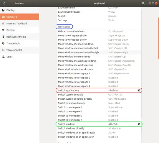

Go to Settings > Devices > Keyboard and scroll down the list of shortcuts. Alt+Tab will be the shortcut for Switch Applications.
What you want is to set Alt+Tab on Switch Windows instead, so click Switch Applications and press backspace to clear the shortcut for it. Click set. Then click Switch Windows and set Alt+Tab there instead. This will give you the desired function.
