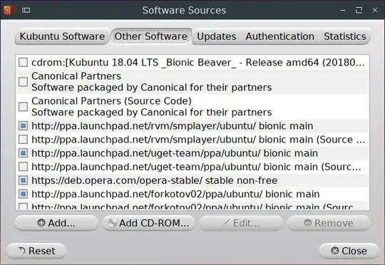

Or, through the Kubuntu's Software -Center (Discover), clicking Settings and the upper-right button
After having installed LXQT desktop (on top of Kubuntu), what I prefer now is to use the lxqt-sudo tool in the Exec line of the .desktop file /usr/share/applications/software-properties-kde.desktop.
Exec=lxqt-sudo software-properties-kde
which shows the window with Qt-GUI (the Qt widget style of KDE/LXQT set under the LXQT settings) instead of GTK.

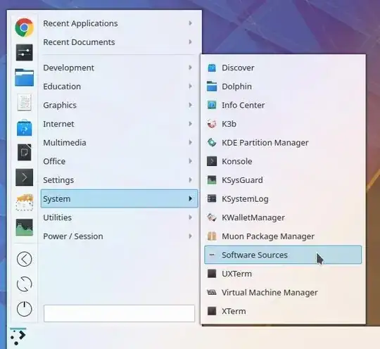

The .desktop file for Software Sources is /usr/share/applications/software-properties-kde.desktop in Kubuntu 18.04 but if you open the file with a text editor, you'll see a line with:
NoDisplay=true
One can comment out that line (and do so each time the package is updated). Alternatively, one could copy over the .desktop file over to ~/.local/share/applications and make the change in the copied file.
Whichever way is chosen, Software Sources can be seen in the launcher under System:

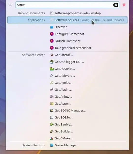

Or, it can be accessed via krunner:
Krunner
Either way, when launched, you'll be prompted for your user password.

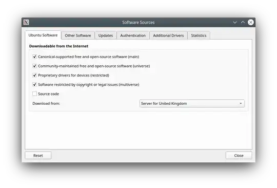

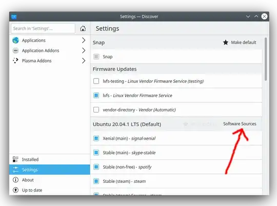

In Kubuntu 20.04 LTS, you can find Software Sources by:
  1. Launching Discover
  2. Clicking "Settings"
  3. Clicking "Software Sources"
You now have opened Software Sources:

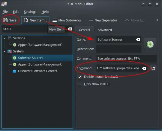

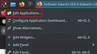

As a complementary answer:
Right click on the application launcher (dashboard, menu) on the panel, select "Edit Applications"
Select new item.
Add a name, icon, and the command
pkexec env DISPLAY=$DISPLAY XAUTHORITY=$XAUTHORITY software-properties-kde
Save.
