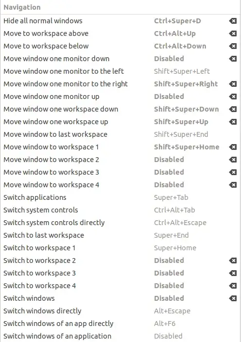

In Settings > Devices > Keyboard > Navigation section
I don't have necessary shortcuts preferences

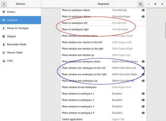

Check your keyboard settings panel. Here's a snapshot of how it looks in 17.10, and you may just have to re-enable them in 18.04.
screenshot

In Ubuntu, I switched vertical workspace to horizontal using Gnome Horizontal workspaces Extensions. Now my default Gnome shortcut keys are:
Shortcut Action
Ctrl + Alt + Shift + Move Window To Right Side Workspace
Ctrl + Alt + Shift + Move Window To Left Side Workspace
Ctrl + Alt + Switch To Right Side Workspace
Ctrl + Alt + Switch To Left Side Workspace
In Ubuntu 18.04, I found that the shortcuts are Super+Left and Super+Right.
Settings > Keyboard
