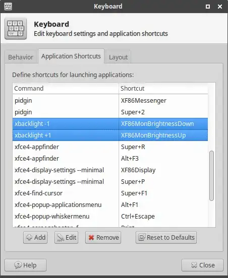

For Xubuntu LTS
Firstly, install xbacklight
$ sudo apt install xbacklight
Secondly, check whether you have control over the backlight.
$ xbacklight -1
$ xbacklight +5
Should these commands result in a No outputs have backlight property error, then follow these remediating steps before proceeding.
Once xbacklight -1 and xbacklight +1 work from the command line, proceed with assigning these commands to respectively the XF86MonBrightnessDown and XF86MonBrightnessUp keys. This is done by hitting those keys when asked by the Settings → Keyboard → Application Shortcuts application.
Finally, reboot for these changes to take effect.

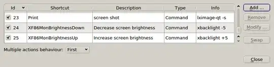

On Ubuntu 16.04, with Intel onchip graphics (i5) under LXQt, it is sufficient to assign xbacklight commands to the brightness function keys XF86MonBrightness(Down|Up) using the global key shortcut settings. These seem to override the defaults even if /sys/module/video/parameters/brightness_switch_enabled is set to Y, while the original functionality on virtual terminals is retained. LXQt global key shortcut configuration with xbacklight commands
An alternative to the original xbacklight would be acpilight, but unfortunately this isn't available as Ubuntu package. As it doesn't depend on an X display running, you can also associate it with ACPI button events and use it from the console. Additionally it can store the current brightness on shutdown and restore it on boot.

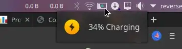

If you're on KDE, you can simply hover your cursor over the "Battery and Brightness" menu from your system tray and try to slowly scroll upwards or downwards to increment or decrement the brightness.

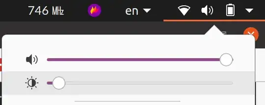

On modern Gnome environment you can achieve fine-control effect with mouse scroll:
If you have smooth-scroll touchpad, position mouse pointer over brightness slider from top-right menu and perform fine two-finger scroll to adjust brightness with tiniest steps.
