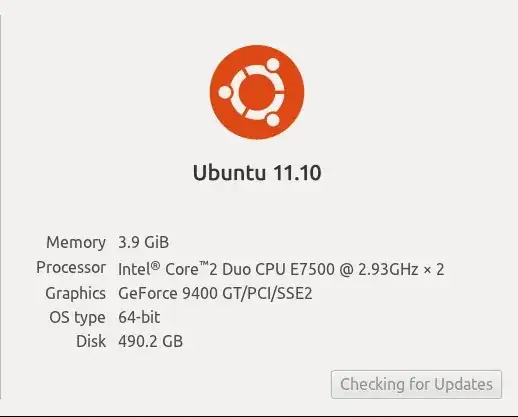

My system was getting slower, especially when I use browsers like Firefox / Chromium and Virtual Machines. I noticed that I've got at least 3.2 GB of free RAM (using Gnome system monitor) and there was no swapping.
What I did now is swapoff -a and system system performance is up by 30%. So my question is: Is it safe to use swapoff? Will it be safe for my PC to restart with swapoff?
