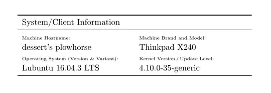

Compiled this looks like:
LaTeX example 01
At the beginning of your script you just create a unique output filename and copy the template:
outfile="/path/to/$(date +%F_%T).tex"
cp /path/to/template.tex "$outfile"

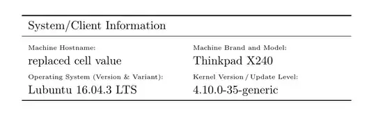

Now you can change this file and adapt it to your needs with sed -i, thanks to the line marks added in comments it's easy to select single cells:
sed -i 's/.*%A2/  replaced cell value/' "$outfile"
When all changes are done just run pdflatex on the .tex file to get the .pdf output:
pdflatex "$outfile"
LaTeX example 02
