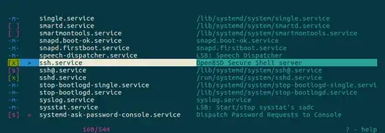

I'm surprised no one has mentioned chkservice yet. A curses tool for enabling,disabling, and starting/stopping systemd units. It's even in the usual apt repo, so you can just sudo apt install chkservice.

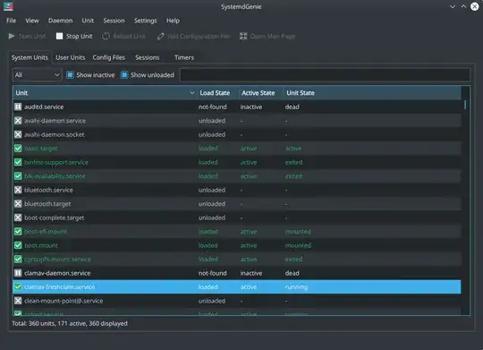

So, if you use KDE, there may be two for you.
A screenshot of SystemdGenie:
SystemdGenie
