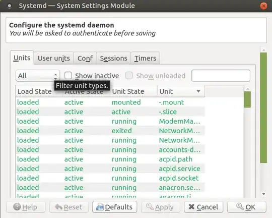

On Ubuntu 18.04 LTS you can use SystemD GUI module from KDE Control Center (packaged as kde-config-systemd). Its description is below:
KDE control center module for Systemd
This package is a KDE Control Center module for the systemd daemon.
It is capable of starting and stopping systemd units.
In addition, it allows for the configuration of several systemd
parameters.
You can install with:
sudo apt install kde-config-systemd kde-cli-tools
And then run with:
kcmshell5 kcm_systemd
It looks like:
