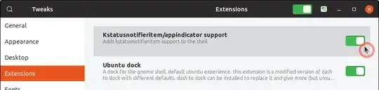

You don't have to uninstall ubuntu - appindicator. Just turning on ubuntu - appindicator first in gnome-tweak, and then install topicon plus, there are no problems.
Edit:
If you don't have it already, install the package gnome-tweaks.
Run "gnome-tweaks" and look at the 4th item called "Extensions". Looks like this:
Make sure you enable Kstatusnotifieritem/appindicator support.
