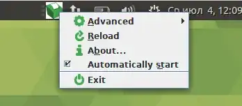

  • At first I tested it in normal traditional desktop - Ubuntu MATE 18.04 LTS and it has tray icon in place here just after installation:
    qz-tray MATE

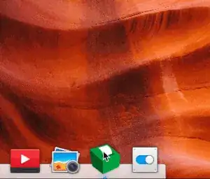

Starting with 2.0.9, QZ Tray detects the absence of a System Tray and attached to the Taskbar icon instead.
Here's QZ Tray running on ElementaryOS:
Solutions including the System Tray compat libs (or avoiding Gnome entirely) are the correct solution for those using older QZ Tray versions, however those looking to use a newer version of QZ Tray no longer need to make special considerations. It should work out of the box.
