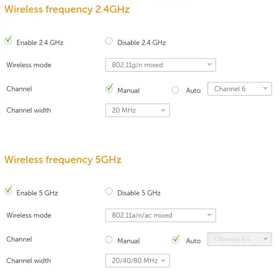

I had the same issue for a long time (Ubuntu 18.04, 19.04 and also 20.04) and none of the solutions from above worked properly for me; the answer here worked ok, but running on 2.4GHz instead of 5 GHz gave performance issues.
What seems to have worked is to switch off the automatic choice of the channel, but set it to manual for the 2.4 GHz option in my router settings (and use auto for the 5GHz option):
I did this a couple of days ago and have not had any issues since then: 5GHz is used for all my devices, performance is excellent and I have not seen any drops anymore (hopefully it remains like this after posting this answer here ;-) ).
