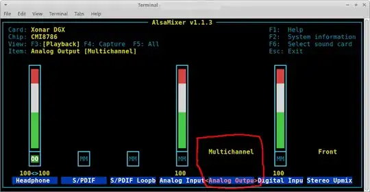

The above solutions didn't work. What worked for me was opening alsamixer and changing Analog Output from Stereo Headphones to Multichannel enter image description here
