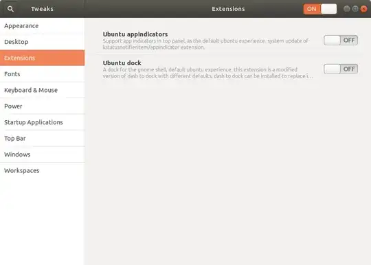

The big dock on the left. In other versions you could escape Unity Launcher by going to GNOME, what now? GNOME tweaks is not showing it as an extension, even though it looks a lot like Dash to Dock.
Tweaks/Extensions dialog
I see autohide options in settings, but no way to completely remove it and use the GNOME default.
Edit: I'm not looking for vanilla GNOME, but simply to hide the dock.

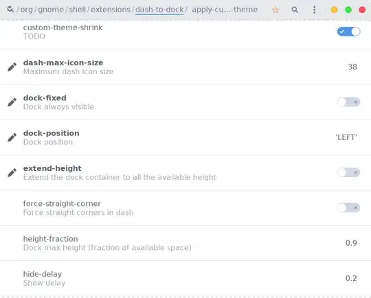

If you want to tweak more use dconf-editor:
You can tweak the dock from dconf-editor. Install it by sudo apt install dconf-tools.
Open dconf-editor and goto org->gnome->shell->extension->dash-to-dock. You can do some tweaks like hiding dock, turn off extending dock etc. dconf-editor
