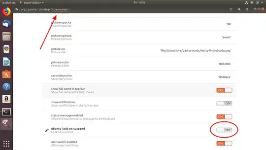

Disable screen lock after suspend by installing dconf-editor
sudo apt install dconf-editor
then navigate to
org/gnome/desktop/screensaver and turn off
ubuntu-lock-on-suspend.
