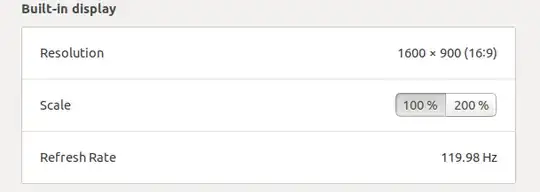

I recently installed Ubuntu 18.04 and discovered that the fractional scaling option that was in 16.04 is no longer there. 200% is too big for my display, and this answer didn't work for me (the options didn't change after running the command).
Is there another way to get fractional scaling?

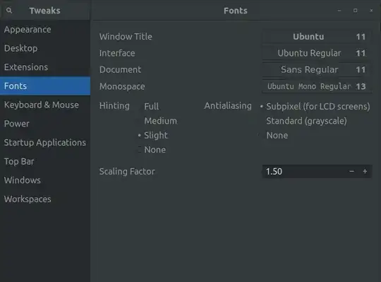

Install Tweaks by running:
sudo apt install gnome-tweaks
Then go to TweaksFontsScaling Factor and change the scaling value.
Gnome Tweaks font settings
At least this option helps to make text bigger.
Actually I like this approach, since it keeps other things at scaling 1, because I only need the text to be bigger.

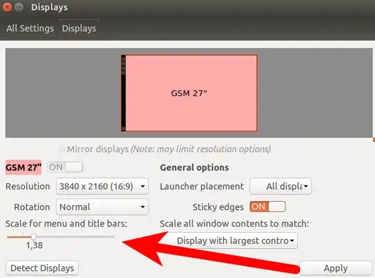

Tried to play with expermential features and some other "tips" found online but nothing helped or seemed like "solution" will introduce another pallet of issues. What i eventually did is - i installed unity desktop manager which was used with Ubuntu 16. So now I have running latest 18 LTS with a bit different desktop manager which does have fractional scaling without any hacks.
sudo apt install ubuntu-unity-desktop

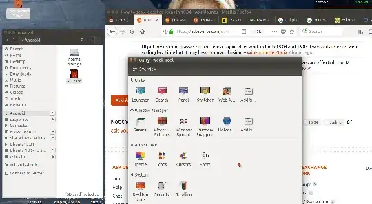

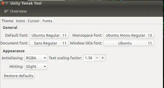

I used Unity Tweak Tool in Ubuntu 16.04. I'm running now a test environment where 16.04 was upgraded to Ubuntu 18.04 LTS. I just checked and Unity Tweak Tool is still there and scaling my High DPI screens properly. The settings I'm using for scaling on a 1920x1080 monitor are:
The Text scaling factor scales both fonts and UI elements like title bars, buttons, etc.
Icon size is preset but the text size under it increases giving the illusion the icon size changed:
In the .gif above scaling starts at 1.38 on a 1920x1080 monitor. Then it is changed to 1 and everything gets tiny, which is normal. Then it is changed to 2 which is ideal for the visually challenged. Once again the icons have fixed pixel size and the font shrinking or expanding under the icon gives the illusion their size is changing.
To install Unity Tweak Tool use:
sudo apt install unity-tweak-tool

The solution with the Gnome Tweak Tool works well for me with Ubuntu 18.04 with a 3840 x 2160 resolution display. After setting only the scale factor to 1.5 and leaving the font sizes unchanged the screen display was great for me. Additionally I had to adjust the size of the dock symbol size in the gnome settings. That seems to me the least intrusive solution.
