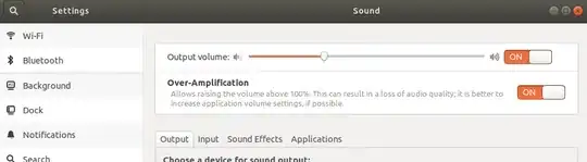

You can change the option in:
Settings -> Sound -> Over-Amplification -> ON
if you want a higher volume beyond 100%
screenshot

Selecting Settings then Sound and turning on Over Amplification solves the problem.
Using the built-in "Settings" GUI permanently solved the problem on my laptop. Using "Settings" -> "Sound" -> "Over-Amplification" to set that parameter to "ON" provides a fixed overamplification percentage of around 30%. This way has the advantage that the fix persists indefinitely, even after you close "Settings" and subsequently use the desktop's built-in audio playback volume slider.
