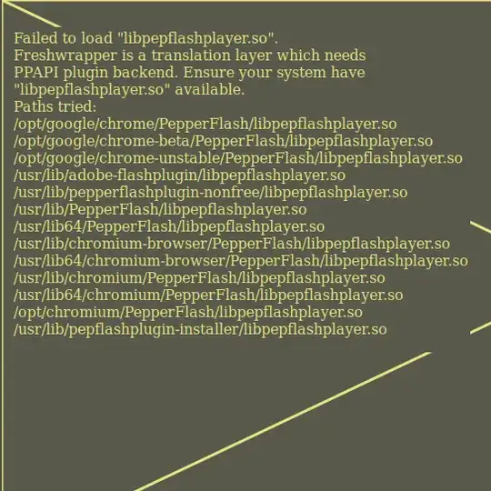

Screenshot before installing flash plug-in: enter image description here

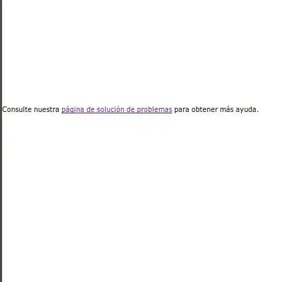

Screenshot after installing flash plug-in: enter image description here

Did some research, and found an issue with the adobe-flashplugin package. Reported as bug #1767476.
Since you are using Firefox, I would recommend these steps for now:
  1. Uninstall the Flash related packages you may have installed:
    sudo apt purge adobe-flashplugin browser-plugin-freshplayer-pepperflash
  2. Install the flashplugin-installer package:
    sudo apt install flashplugin-installer
  3. Restart your web browser.
Edit 2018-04-28:
The bug seems to have been fixed, so this page ought to apply as usual again.
