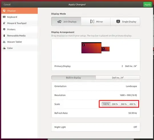

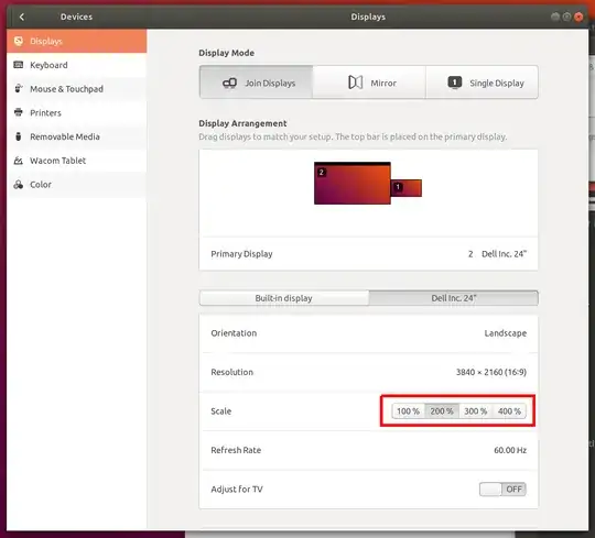

I have a Dell monitor set to a scale of 200%:
I then set the laptop built-in display to 100%:
However, if I then switch back to the Dell monitor settings, the scale there has reverted to 100%.
Is there a way to have 200% scale on the Dell monitor and 100% scale on the laptop monitor?
Thanks!
