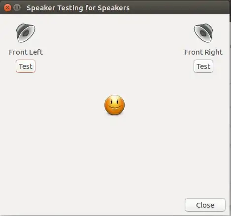

I am running 16.04LTS with a multi-speaker enabled laptop (4.1 surround). I am trying to get the audio working on all the four internal speakers. The default audio management package alsa-mixer is supposed to detect all the speakers and the subwoofer correctly, but it is not. Only the subwoofer is working and it is getting mapped to the Front Right in Sound Settings > Output > Test Sound.
Image : Only two speakers detected

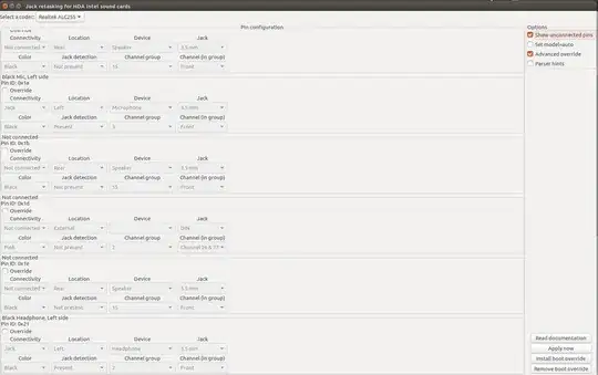

I read a bit and found that the audio pins are not getting retasked properly, and this is already a bug (Bug report : Launchpad), and using HDAJackRetask it is possible to retask all the pins manually to the respective speakers. I found a post using the same audio codec as mine (Realtek ALC255, Link) which makes the real speakers and the subwoofer work correctly, however the front speakers are still don't work. Here is a screenshot of all the configurations available in HDAJackRetask on my machine :
Part I
Part II
