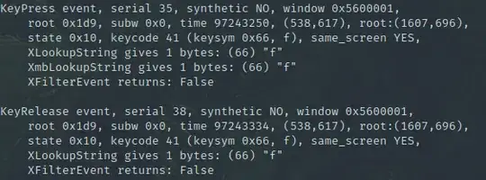

Yeah, xev should do the trick. If I'm remembering right you can find it in the x11-utils package. Run xev and press the keys you want, it'll spit out a bunch of info for each event:
For just keyboard events, you should launch it in a terminal with xev -event keyboard to tell it to ignore non-keyboard events like mouse moves.
