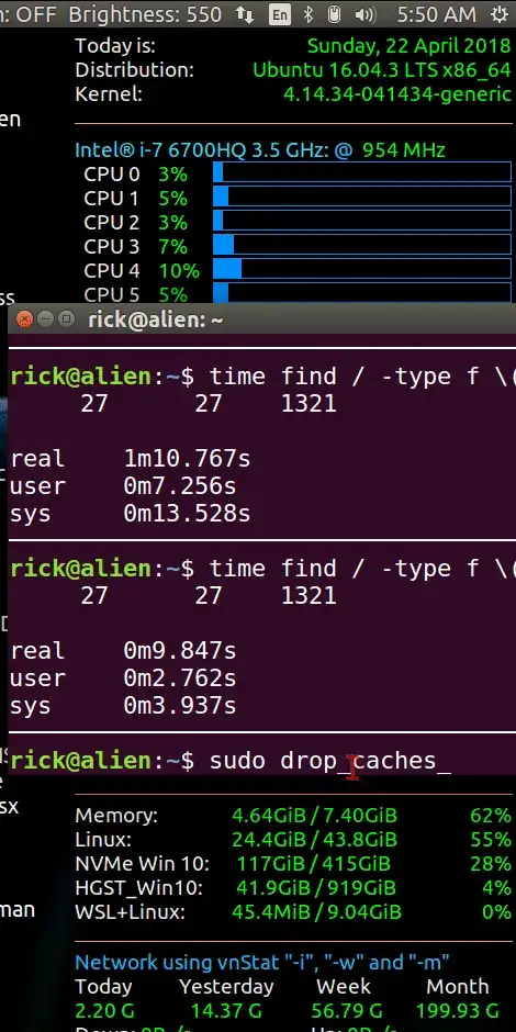

I'm working on a project to find all the .tar installation files on my system using the command:
time find / -type f \( -name "*.tar" -o -name "*.tar.*" \) 2>/dev/null | wc
The first time it runs I get:
real    1m10.767s
The second time it runs I get:
real    0m9.847s
I would like to always get the second time performance of < 10 seconds and forgo the initial performance of 1 minute 10 seconds. What is the best way of avoiding the one minute penalty the first time find is used?

TL;DR
Drop RAM caches that speed up find disk access
You can repeat first/second performance tests by calling this little script before the first find:
#!/bin/bash
if [[ $(id -u) -ne 0 ]] ; then echo "Please run as root" ; exit 1 ; fi
sync; echo 1 > /proc/sys/vm/drop_caches
sync; echo 2 > /proc/sys/vm/drop_caches
sync; echo 3 > /proc/sys/vm/drop_caches
GIF showing how much RAM disk caching consumes
The find command run across / will consume about 500 MB of cache buffers as the .gif below shows when they are dropped:
^^^--- Notice the memory line immediately below the terminal window shows a drop from 4.74 GiB to 4.24 GiB. It actually drops to 4.11 GiB after the peek screen recorder saves the file and closes. On my system find disk caching is using about 5% of RAM.
