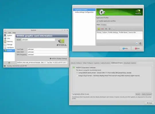

I described in my answer that I switched to use Xubuntu 16.04. I managed to install Nvidia driver through PPA, and I did not get stuck on the log in screen. I have set secure boot to off. I now switch to use a proprietary driver. This way I can open Nvidia settings, but Nvidia settings does not list any GPUs.
However, something is still wrong with my graphics card.

  2. In Software & Updates the graphic card is unknown:
