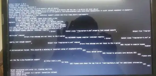

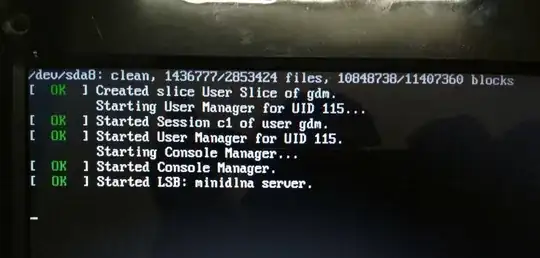

I ran fsck, there was no errors shown. I tried booting with nomodeset, then screen doesn't flicker, but the booting stops at the below screen.
At this point, I am able to open a terminal by hitting Ctrl+Alt+F1. I am able to login there. If I enter the command startx, this is happening.

First: The error complains about possibly being out of space. You can attempt to recover space by booting into recovery mode from the grub menu and selecting "clean".
You can also attempt to boot into the command line and remove unused packages by running the command:
sudo apt-get autoremove
While in command line, you can also navigate through and delete any documents/pictures/videos etc. you don't need in attempt to clear even more space.

Second: Try starting without nomodeset. For me, I only need to use nomodeset during install, after I update all of my drivers it is no longer necessary.
