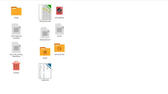

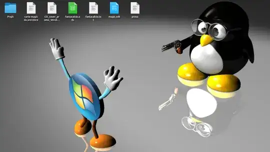

If I use task switcher to show the desktop, I obtain the first time:
The second time:
And so on further. Why?

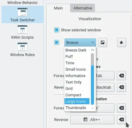

From Arch Linux this user writes:
So in KDE you can change the design of the Alt+Tab application switcher. On my previous installation, I always used one called "Large Icons", which was a Mac OS inspired application switcher that only showed icons. In my installation this switcher is no longer available (Settings -> Window Management -> Task Switcher). I can only select Cover switch, Flip switch, Breeze and Breeze dark. Does anyone know where that nice application switcher went?
The solution (which might be your original problem) could be "Large Icons" as this screen (from the Arch Linux link) shows:
kde-alt-tab
