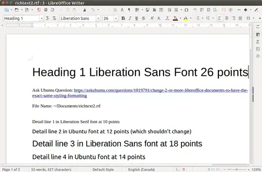

Create Test Data
Create two or more files containing:

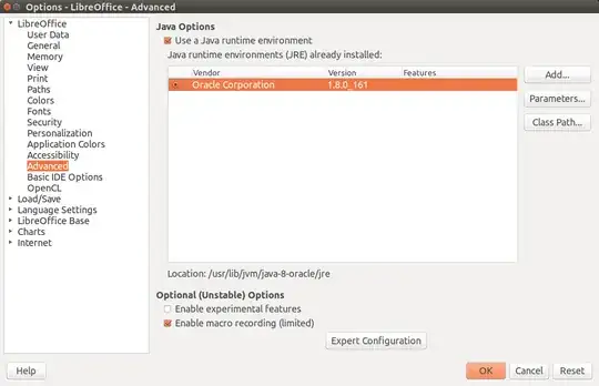

Now open LibreOffice and select Tools -> Options -> LibreOffice -> Advanced and setup this screen:
Click the options for:
  • Use a Java runtime environment
  • Oracle Corporation 1.8.0_161
  • Enable macro recording (experimental)
  • Click OK
  • You will be asked to restart, click "Restart Now".

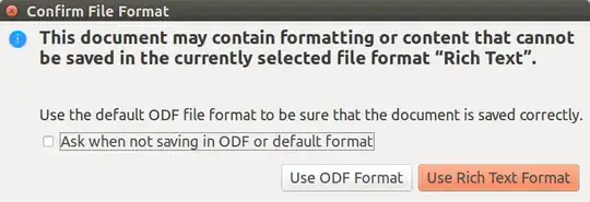

Turn Off Dialog
Do a file save and this dialog comes up:
Turn this message off as show in the screen. The macro may not run properly if this option is on.

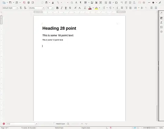

Here's a one off approach using Libre Office. It's not batch, but it may help inspire other answers.
Open an rtf file that has the Ubuntu font, H1 at 28 pt, some text at 12pt and some at 18 pt.
Here's an example:
test rtf

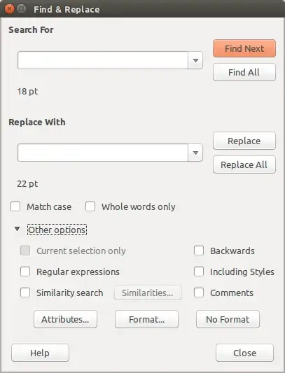

The following steps will apply the change requested in your question "if font-size: 18px {make it 22px} # All text with font-size 18px is now 22px;"
Click Edit→ Find & Replace on the menu or hit CtrlH Other options Click Search For box then attributes button Font size check box then Format button select 18 pt from the scroll box on far right Click Replace with box then Format button and select 22 pt from the scroll box on far right
FindNreplace
Click Replace All
the applicable line that changed was:
\par \pard\plain \s0\ql\widctlpar\hyphpar0\ltrpar\cf1\kerning1\dbch\af7\langfe1081\dbch\af7\afs24\alang1081\loch\f3\fs24\lang1033\ql\widctlpar\hyphpar0\ltrpar{\rtlch \ltrch\loch\fs36\loch\f6
the fs36 changed to fs44
